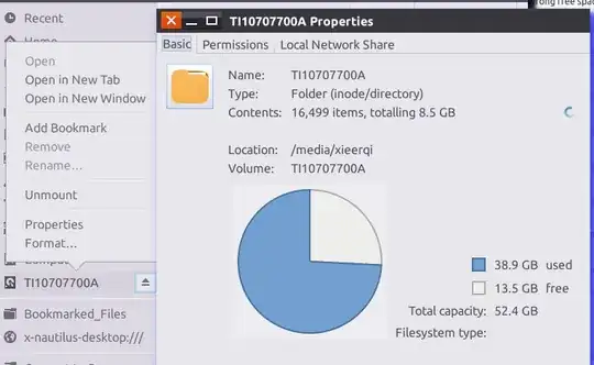

You can, however, visualize usage by right clicking on each mounted (!) disk partition in the right side panel, via Properties menu:

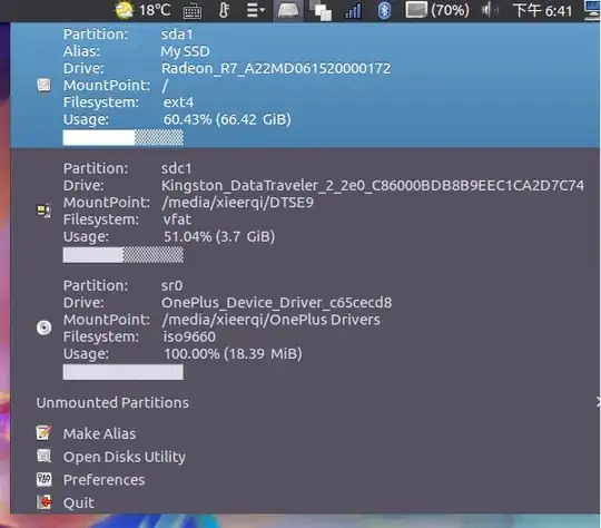

There are alternative ways, for instance via Disk Usage Analyzer, as Ben suggested. I've written a Udisks Indicator, which shows mounted partitions and their usage in top-right panel, so that could be another alternative. Screenshot is below.
