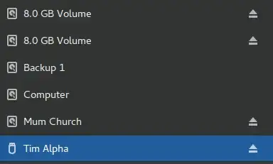

This is the sidebar of my nautilus window. You can see two different icons - one for the USB sticks and one for drives.
How does nautilus determine which gets a hard drive icon and which gets a flash drive one?

TL;DR: Nautilus uses Gio's GDrive,GVolume, and GVolumeMonitor interfaces to obtain icons corresponding to particular device.
Gio's API, drives and icons
Gio has set of classes which allow applications to read available drives and volumes, and what icons are associated to them (and that's something API already handles). The icons are returned as Gio Icon type, so applications don't particularly have to know where the icon is located, however requesting an icon by name or by full path is always possible. There's two types of icons you will see, "symbolic" and custom, and "symbolic" icons are sort of standard. If one looks through /usr/share/icons they'll find there are lots of icons that end with -symbolic in their name, stored across multiple theme folders (standard Adwaita, Humanity, and Oxygen are good examples) , typically .svg files. In the screenshot in the question, the icon for hard drive is drive-harddisk-symbolic and drive-removable-media-usb. When user switches desktop theme, the application doesn't have to look up full path to the icon - so long as there is drive-harddisk-symbolic icon in the theme folder, the Gio will find it and return to the application. How do I know all this ? I've used those same icons for my own UDisks Indicator (though my approach differs from what Nautilus does).
How Nautilus utilizes Gio's api
From reading Nautilus source code, specifically nautilusgtkplacesview.c code, essential parts are the following:
  1. Nautilus adds drives and volumes (think partitions). There's add_drive function, which uses Gio's g_drive_get_volumes (drive) function to get volumes on specific drive, and passes that information to Nautilus's add_volume() function. Gio's g_volume_monitor_get_volumes() on lines 1139 and g_volume_monitor_get_mounts() 1164 fetches volumes that may not be associated with a drive (such as ftp or network shares), but that same information goes to add_volume() function and add_mount().
  2. Icons are queried for mountpoints and volumes: Inside add_volume() function, Gio's g_volume_get_icon() function fetches the icon of type GIcon. Inside add_mount() Gio's g_mount_get_icon() also of type GIcon. In both cases, icon along with other information are combined into an object of type NAUTILUS_TYPE_GTK_PLACES_VIEW_ROW and passed to insert_row() function
  3. Rows inserted into Places container: The Places menu that you show in the example actually is one of the basic Gtk container types - Gtk Box. Inside that box there's ListBox for subsections - that's why there's separators for all user's folders, drives and volumes, and bookmarks. Nautilus creates an object which extends from Gtk Box type, G_DEFINE_TYPE_WITH_PRIVATE (NautilusGtkPlacesView, nautilus_gtk_places_view, GTK_TYPE_BOX) . The G_DEFINE_TYPE_WITH_PRIVATE is another standard function , and as you can see in Nautilus's definition the last item defines GTK_TYPE_BOX - parent object. In the .c file on line 50, NautilusGtkPlacesViewPrivate structure is defined, which among other things has pointer to ListView widget. That's the actual contents of the object.
    Now, insert_row() function takes instance of that type (NautilusGtkPlacesView *view), connects whole bunch of signals to the row item it received as argument, and using gtk_container_add inserts all the information ( along with the icon ) into the ListBox widget of the Nautilus Places object.
