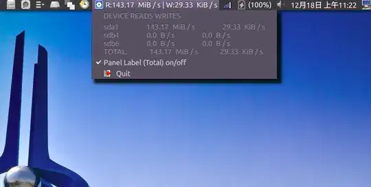

As indicated in the comments, I've written a custom indicator to display disk i/o usage. It allows displaying total usage in the panel as well as per-device information in the indicator menu. It provides information on i/o usage of only those devices that are mounted and adapts its information when devices are mounted/unmounted. Panel text can be turned on-off, and basic settings can be controlled via ~/.diskstat_indicator.json file. enter image description here

Since the ever changing speed of reads and writes total affects the length of text in the panel, it will constantly move other indicators back and forth. This can get annoying really fast, which is why I've added an option into the menu that will disable/enable panel text. The total information still can be seen via the menu. Notice that the information field is a non-selectable menu item simply because there's no action associated with that menu item. It might have something in future, but the primary function of this indicator is to display data, rather than serve as action-oriented indicator.
