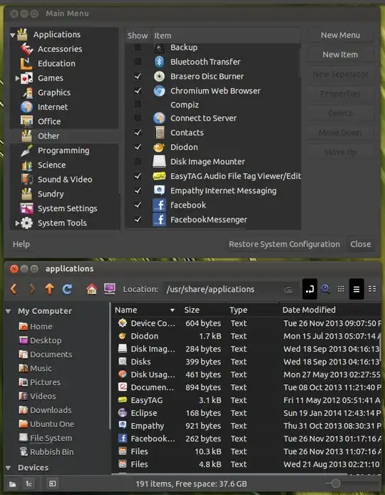

I upgraded Eclipse yesterday to version 4.3 and was faced with the missing menus bug. To get the menus back one has to start Eclipse in a different way, thus I tried to create a new item in the Main Menu.
For some reason the item is not stored by the Main Menu, I get no error messages when I click the OK button in the new item dialogue, but nothing changes in the Application group.
Am I doing something wrong? Thanks.
Update I: user wilf tells me to add a file named eclipse.desktop in /usr/share/applications but this has not created an new item in the Main Menu:
Update II: Here's how my eclipse.dektop file looks like:

$ cat /usr/share/applications/eclipse.desktop
[Desktop Entry]
Type=Application
Name=Eclipse
Icon=eclipse
Exec=env UBUNTU_MENUPROXY=/usr/local/eclipse.kepler/eclipse
Terminal=false
Categories=Development;IDE;Java;

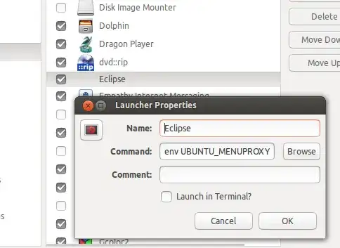

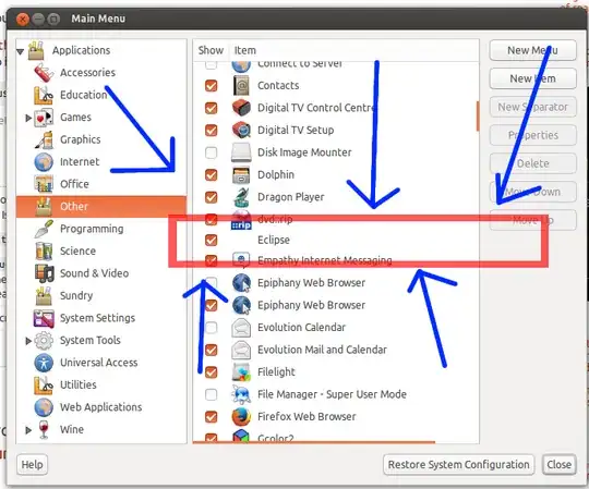

I think that you are referring to Alacarte. For some reason, that does not always save the changes.
I would do as this answer suggests, but remember, even if you have no .desktop file for Eclipse, that this should do it for you:
sudo nano /usr/share/applications/eclipse.desktop
And here is the properties window in case you don't believe me:
