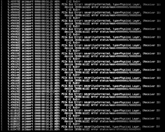

Now when you start your computer you will see status messages when grub calls Ubuntu. The last status message before computer freezes is the error we need to track down and fix.
Resolution
Upon reviewing boot errors OP discovered problem was a duplicate of:
