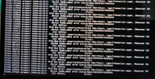

and I noticed that every now and then (maybe once every two days) it "crashes". The crash is gradual: maybe a single window freezes, and when I move to another window, the other one freezes too, until eventually the mouse freezes. Some time ago, when it started, I pressed Ctrl+Alt+F1 and saw the following error:
# For future search engines, here is one of them:
[91325.503864] pcieport 10000:e0:1d.0: PCIe Bus Error: severity=Uncorrected (Non-Fatal), type=Transaction Layer, (Receiver ID)
[91325.503920] pcieport 10000:e0:1d.0:   device [8086:a0b0] error status/mask=00200000/00000000
[91325.503964] pcieport 10000:e0:1d.0:    [21] ACSViol                (First)
It keeps printing this forever... and eventually even the keyboard becomes irresponsive. Still, the camera button and the keyboard light remain working, as well as the screen (who keeps printing this ominous message). Currently, I'm planning to leave another computer pinging an SSH server on it to check whether it also stops the network.

My case - everything is made by intel (cpu, disk) and I got same problem as yours. Before on laptop (asus vivobook 15) I had windows 10 and it starts freezing randomly and nothing helps. Disk falling in i\o errors after I tried to install kubuntu distro. But after I finally install ubuntu-server minimal distro (disk is available about 1 min for all operations and after that - freezes and only available solution - is hard reset via power button).
Then I installed latest linux-hwe kernel, but it is didn't help. In BIOS you should disable intel VMD (because ubuntu 24.04 it doesn't work correctly with him). Solution is adding the following to the kernel cmdline into /etc/default/grub:
nvme_core.default_ps_max_latency_us=0 pcie_aspm=off
Nothing else. My config looks like:
GRUB_CMDLINE_LINUX_DEFAULT="loglevel=3 nvme_core.default_ps_max_latency_us=0 pcie_aspm=off
I spent about 10 hours on this. I hope you get to this answer much sooner. Good luck. Here is thread where i found solution: https://github.com/pop-os/pop/issues/2666
