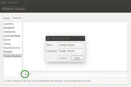

Go to System Settings - Keyboard - Shortcuts. Click on "Add" button.
(See here for how to create a custom shortcut: http://web.archive.org/web/20150705203244/http://bigknol.com/create-custom-keyboard-shortcuts-in-ubuntu-for-launching-chrome-firefox/)
For the name write,for example name of the input language - "English".
For the command write
gsettings set org.gnome.desktop.input-sources current 0
Here 0 indicates the number of the input language. (0 for the first one, 1 for the second one, etc.)
Then press on create a shortcut button and press the key combination you want.
Change the number according to the order of input languages. For example write
gsettings set org.gnome.desktop.input-sources current 1
for creating a shortcut for the second language.
