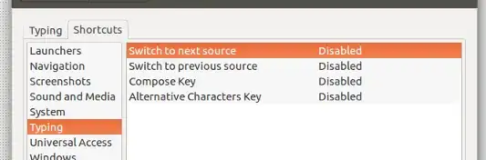

  3. If all works fine, open System Settings, go to "Keyboard" > "Shortcuts" > "Typing". Click on the shortcut to switch source (on the right, to set the shortcut), and hit backspace to disable the shortcut.
  4. Now add the same shortcut to custom shortcuts: choose: System Settings > "Keyboard" > "Shortcuts" > "Custom Shortcuts". Click the "+" and add the command:
    python3 /path/to/change_lang.py +
    To the shortcut you just disabled in step 2.
