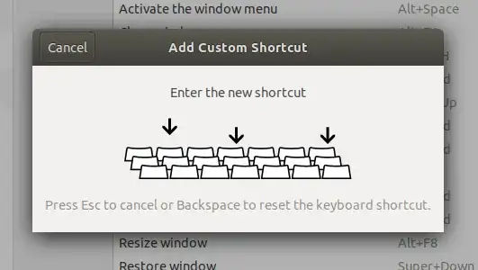

I've migrated to Ubuntu 18.04 Desktop via a clean install and discovered that I can't do the same. I was gonna use this solution, but in 18.04 the CapsLock key can't be used as a hotkey:
Add Custom Shortcut window
In this dialog, the CapsLock key either does nothing or reveals the Cancel button. The Save button becomes visible only when I press a combination of a modifier and a character key.
So how do I configure CapsLock to switch to English (regardless of how many times it's pressed) and Shift+CapsLock to switch to Russian?
