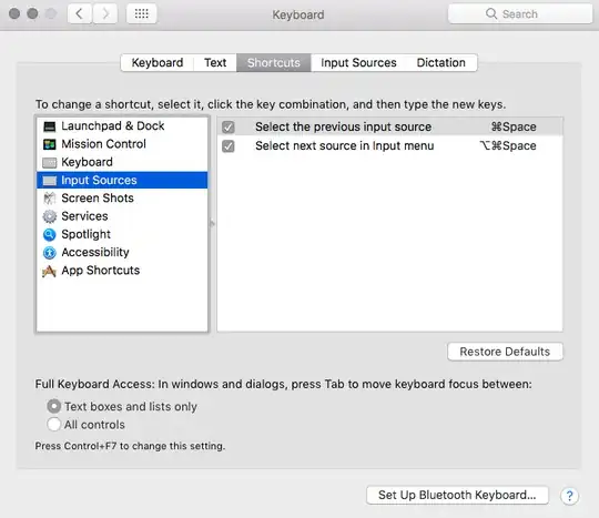

I am looking for a way to do this as it is implemented under MacOS, where switcher cycles between the 2 last languages by default, but you can force it to advance to 3rd one using a separate shortcut or via toolbar menu, as shown in the screenshot below:
Is it possible to configure something like this on Ubuntu?

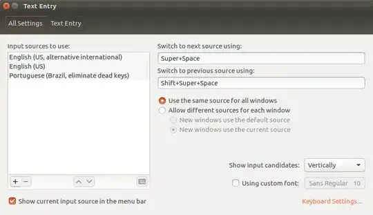

Go: >System Settings > Text Entry
  and add languages to "Input sources to use:"
make sure to check "Show current input source in menu bar" just select input sources from the drop down menu.
