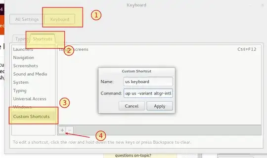

When you have it, open Settings -> Keyboard -> Shortcut Tab, go on Custom Shortcut, and add (with the +) the shortcuts:
keyboard settings
Type a name and the command you need. After that, you need to click on the "Disabled" word and type your shortcut:
keyboard settings 2
And you're set.
