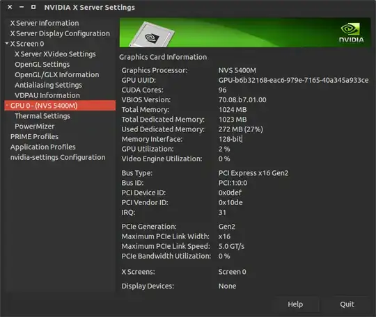

nvidia-settings utility
On Ubuntu 15.10, after I installed nvidia-352 and the GPU seems to work (see e.g. these steps):
nvidia-settings
shows something like:
Note how it shows:
GPU 0 - (NVS 5400M)
where NVS 5400M is my GPU model. Also tested on a Quadro K1100M. This did not show up before I had installed the driver.

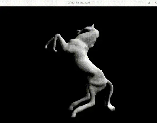

Run a benahcmark and see FPS
In the end, the only test that matters is to do a benchmark with / without GPU and see your FPS goes way up or not: How to perform a detailed and quick 3D performance test e.g.:
sudo apt install glmark2
glmark2
which shows:
and should raise your usage to 100% no matter what as it renders as many times as possible. If we run for one second:
glmark2 -b build:duration=1
it outputs to the terminal:
glmark2 Score: 4551
which is the average FPS.

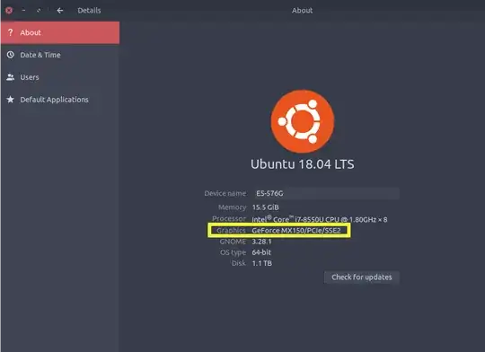

The easiest way to check is go to Settings -> Details -> About
Settings

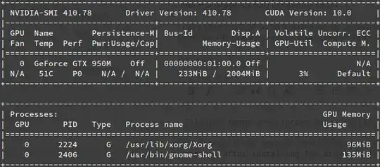

Try this I think it'll work:
nvidia-smi
It will give you something like this

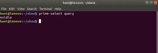

I think one of the easiest ways is to run this command prime-select query in the terminal.
The output will be the graphic card that is used by your PC.
Here is an example:
enter image description here If you want to switch between the graphic cards you have, use sudo prime-select <graphic card name>

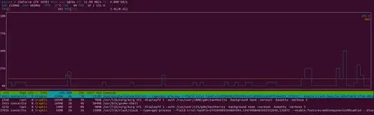

I suggest nvtop tool, it is easy to watch in real-time. It also shows in a graph.
$ sudo apt install nvtop
$ nvtop
