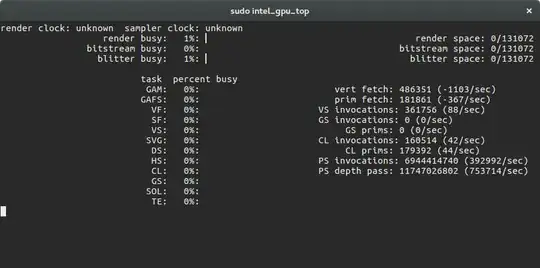

For Intel:
  1. Install intel-gpu-tools (its likely that they are installed already)
    sudo apt-get install intel-gpu-tools
  2. Start the top like utility with
    sudo intel_gpu_top
  3. Check your stats and then exit with Ctrl+C
Thats what you get:

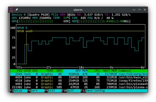

No one mentioned the nvtop ? A nice tool similar to the htop we used to. Installation is easy, simply do:
$ sudo apt install nvtop
or
$ snap install nvtop
The version from snap is usually a lot newer. The attractive feature is that it shows which process uses GPU by how much. A typical screenshot looks like the following: enter image description here

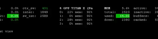

You can use the monitoring program glances with its GPU monitoring plug-in:
  • open source
  • to install: sudo apt-get install -y python-pip; sudo pip install glances
  • to launch: sudo glances
Screenshot: close-up to glances's load details
It also monitors the CPU, disk IO, disk space, network, and a few other things:
Screenshot: glances running

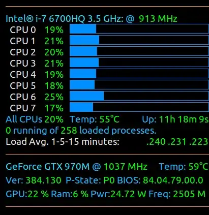

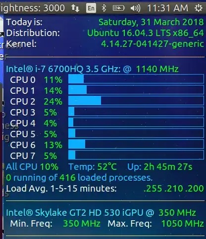

Conky
I like to use conky as a real-time monitor for both CPU and GPU. Installation is straightforward:
sudo apt install conky
Intel i7-6700HQ iGPU HD 530
In this instance I've booted using the integrated GPU rather than the nVidia GTX 970M:
The conky code adapts depending on if booted with prime-select intel or prime-select nvidia:
nVidia GPU GTX 970M
In this instance I've booted using the nVidia GTX 970M rather than the integrated GPU:
Conky code
The conky code was recently modified to auto-sense the GPU. Now it doesn't have to be hand modified when rebooting to a different GPU:

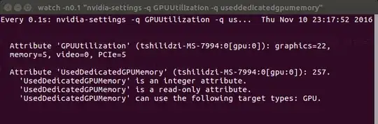

Or :
watch -n0.1 "nvidia-settings -q GPUUtilization -q useddedicatedgpumemory"
And on AMD, use:
aticonfig --odgc --odgt

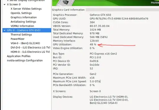

In my case nvidia-smi did not show the GPU load %, only the memory (guess my GTX 650 is too old).
What did work for me was the NVIDIA X Server Settings GUI app (shipped with the driver I believe). Navigate to the section named GPU 0 - (Your Model) - it shows the detailed status info of your GPU usage, updating every 2 seconds:

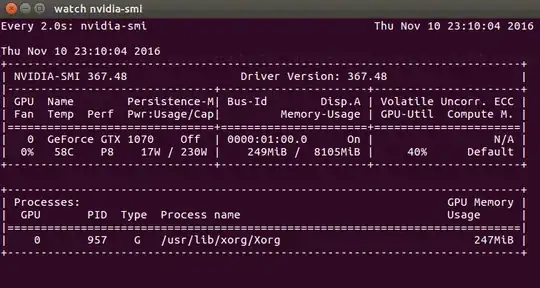

I'm surprised that no one mentioned this command:
watch -n 1 nvidia-smi
