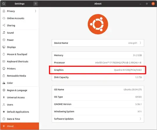

Settings -> About (tested Ubuntu 20.04, 23.04)
You can either open settings by clicking on top right menu, or you can just do:
  • Super key (AKA Windows key)
  • Type "about" and select the entry
So under "Graphics" I can see that my GPU model is
Quadro M1200/PCIe/SSE2
Some other things it can show:
  • "Software Rendering" (Ubuntu 23.10): graphics card not working at all
  • "NV117": I think this means it is using Nouveau

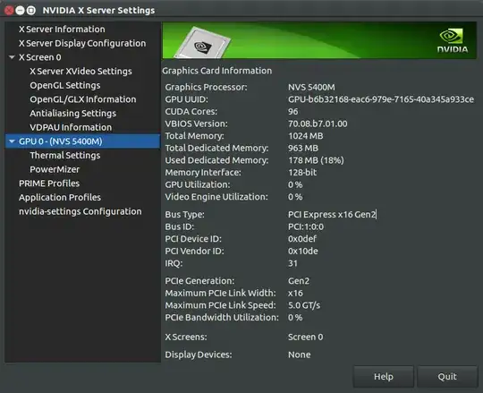

nvidia-settings
Mixes runtime with some static info.
More details: How do I check if Ubuntu is using my NVIDIA graphics card?
