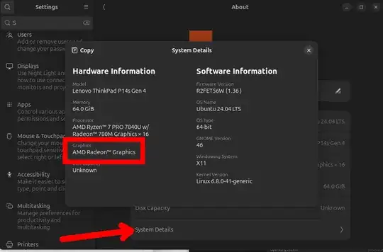

Ubuntu 20.04 Settings -> About
You can either open settings by clicking on top right menu, or you can just do:
  • Super key (AKA Windows key)
  • Type "about" and select the entry
So under "Graphics" I can see that my GPU model is
Quadro M1200/PCIe/SSE2
Some other things it can show:
  • "Software Rendering" (Ubuntu 23.10): graphics card not working at all
  • "NV117": I think this means it is using Nouveau
Tested as of Ubuntu 24.04, it moved slightly, now you have to:
Settings > System Details > Graphics

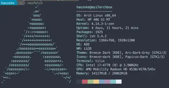

I do believe the best option for this is neofetch.
# Get neofetch
sudo add-apt-repository ppa:dawidd0811/neofetch
sudo apt update
sudo apt install neofetch
# Run neofetch
neofetch
This gives an output like this:

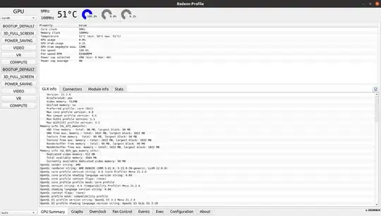

For AMD based graphics card(GPU), you can use radeon-profile application to get detailed information about the cards. It provides temperature, clock, Vram usage etc. (Github repository link)
Step1: sudo add-apt-repository ppa:radeon-profile/stable
Step 2:
sudo apt update
sudo apt install radeon-profile
Step 3: run radeon-profile
Output screenshots (I have two GPU cards, card0(integrated) and card1(discrete)): AMD integrated GPU AMD Discrete GPU
System specification:
  • Ubuntu 20.04 LTS
  • CPU: AMD® Ryzen 5 4600h
  • GPU: AMD® Radeon rx 5600m
Source
