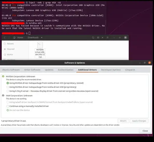

I'm using Ubuntu 19.10 and I want to make sure that my graphics card is putting in its time and not free-riding off my CPU. I downloaded the driver, that I believe should be right, from NVIDIA's website. Currently, I have the 3rd party driver downloaded. I'm thinking that maybe I should switch the drivers out, but I'm not sure how to do that on my version of Ubuntu.
My laptop should have the Quadro P620 in it, but the SystemDetailsAbout page says that the graphics are coming from Intel UHD Graphics 630. That doesn't seem like they'd be the same thing to me, but I am very new to Ubuntu.
Here's a screenshot of what I've got going on.
Software and updates
And one more for good measure.

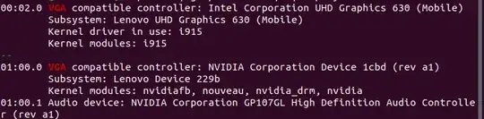

And the one I was asked to include (lspci -k | grep -EA3 'VGA|3D|Display').
lspci output
Disable Secure Boot in UEFI aka BIOS settings and the Nvidia driver will be up and running.
See Why do I get "Required key not available" when install 3rd party kernel modules or after a kernel upgrade? for explanation why isn't it loading now.

nvidia-settings will provide you the option of choosing performance, which should make your Nvidia card preferred over for all graphics related things instead of i915, your CPU's integrated GPU. This is probably one of the more important steps, and you may need to install the Nvidia proprietary drivers, reboot, set to performance, and reboot again.
nvidia-smi is failing to load because nouveau is loaded.
You do not need to disable SecureBoot because:
  • Ubuntu's distribution kernel does not force modules to be signed validly (CONFIG_MODULE_SIG_FORCE is not set)
  • You've shown that it is loaded
