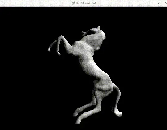

glmark2 getting started
https://askubuntu.com/a/194468/52975 mentioned it, here are a few more pointers. Install:
sudo apt install glmark2
The help shows all benchmarks and their options:
glmark2 -l
E.g. to run the benchmark terrain with duration of 1 second instead of the default 10 seconds:
glmark2 -b terrain:duration=1
or for multiple options:
glmark2 -b build:duration=1:model=horse
Each test outputs a "glmark2 Score" line on the command line, e.g. on Ubuntu 23.04:
    glmark2 2021.02
    OpenGL Information
    GL_VENDOR:     NVIDIA Corporation
    GL_RENDERER:   Quadro M1200/PCIe/SSE2
    GL_VERSION:    4.6.0 NVIDIA 515.105.01
[build] duration=1:model=bunny: FPS: 2780 FrameTime: 0.360 ms
                                  glmark2 Score: 2780
According to https://github.com/glmark2/glmark2/issues/31 that number is simply:
the average of all the FPSs from the benchmarks that were run
so we gladly see that it is not limited to the screen refresh rate.
Their source code is at: https://github.com/glmark2/glmark2 and the license is GPL-3.0.
