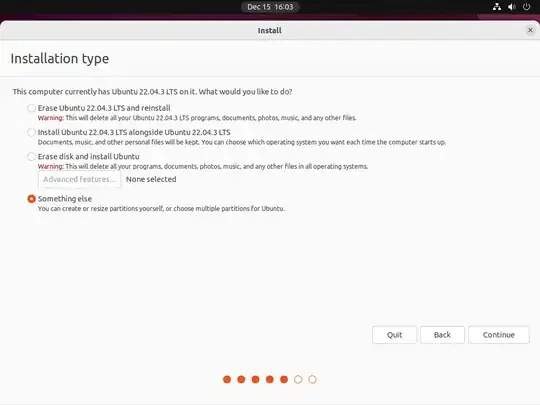

Yes! You can keep the existing home partition using one of the advanced installation options called Something Else
After choosing this option, you will be able to tell the installation process to use the existing / and /home partitions.

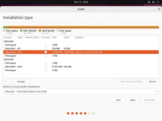

Select the existing Ubuntu system partition /.
Click the Change... button below and make sure:

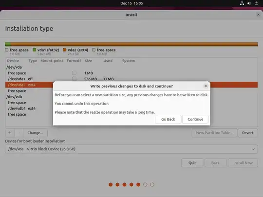

Once everything as set, click OK, you will see a warning popup message like:
Click Continue.

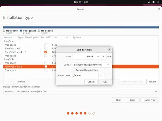

Select the existing Ubuntu HOME partition /home.
Note the partition will not be marked as Home. Click the Change... button below and make sure:
  • The Use as: is Ext4 journaling file system
  • The format partition box is NOT checked
  • The Mount point: is /home
Once everything as set, click OK, you will see a warning popup message like before.

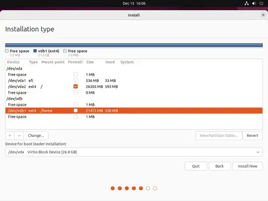

The final Install Type window will look something like this:
Note:
  • The system partition must have the mount point / and format box is checked.
  • The Home partition must have the mount point /home and format box is NOT checked.
Warning: If the format box for the home partition is checked, you will lose all your personal files.
Once you are satisfied, click Install Now and continue as usual.
