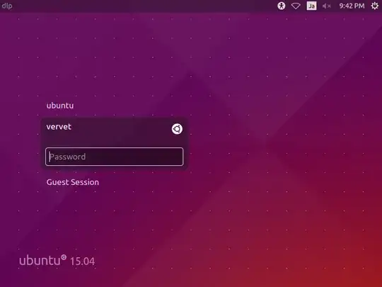

After you have done this, you should reboot and then at the login menu you would click the Ubuntu icon next to your username and change it to KDE/Kubuntu (I am unsure what the exact name of it is) as seen in this picture: change desktop environment
