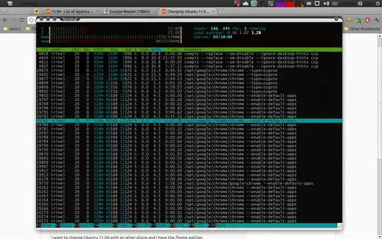

The reason why I want to make the change is that Ubuntu is using a lot of RAM; even my WindowsXP with 512 RAM is working better than 1GB of RAM on Ubuntu. But maybe I'm the only one which thinks that an operating system should not respond to clicks after some seconds or to use all the RAM and Swap although only one program is running...
