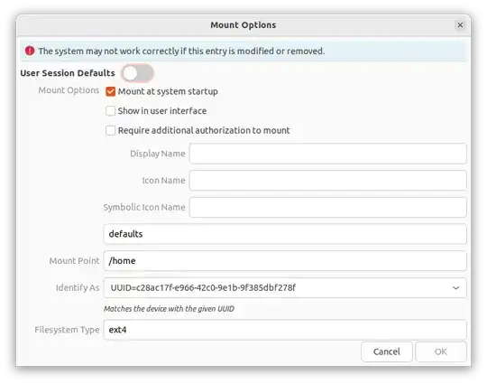

You will see a new window open: enter image description here
Make it look the the image above. Particularly, in this order:
  1. Identify As: Select from the drop-down menu: UUID=Abunchofnumbersandletters
  2. Mount Point: /home
Note defaults is the only option you need for the "home" partition. The current options, "nosuid, nodev, nofail" are for partitions (and drives) that are to be temporarily mounted, for example, a partition in an external USB drive.
In general the mount point /media/$USERNAME/something is for temporarily mounting a partition that may or may not exist in the future. These temporary partitions are mounted for only the current user. /home should be mounted so that all the users can access and use their own "Home" folders such as /home/myname/, home/myspouse/, /home/mychild/ etc.
Click OK to save the changes.

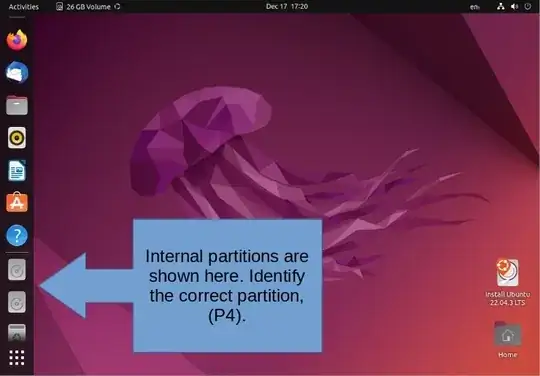

Clean Up
Once you are satisfied that everything is working as expected, you may want to delete the folders created inside the mount point /home during the installation process. You will have to boot from the Live Ubuntu installation USB to do that.
Use the Try Ubuntu option when you boot from the Live USB.
Look for the Ubuntu installation partition (what you call "P4") in the Dock:

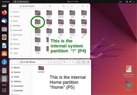

Do not select the P5 partition! If you do, you will lose all your files and folders!! I am showing the content of the equivalent of both P4 and P5 below:

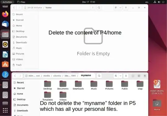

Navigate to the folder /media/ubuntu/blablabla/home, where blablabla is the UUID of your / partition (P4).
First make sure your important files are not in /media/ubuntu/blablabla/home/Your_USERNAME/Documents/ etc. If you are satisfied, delete the folder /media/ubuntu/blablabla/home/Your_USERNAME/.
Do not delete the /media/ubuntu/blablabla/myname/ folder. This is your mount point for the home partition. If you delete it, your computer won't boot.
