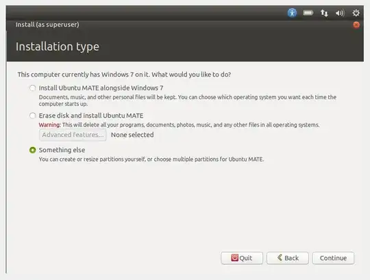

If you want to install Ubuntu to Replace the existing Linux Mint, When you come to this page, enter image description here
choose "Something Else".
The next page gives you the choice of Selecting the Partitions for EFI, Root, Home... Choose the ones that pertain to the existing Linux Mint and proceed with the installation.
Opt for formatting the "/" drive.
If you have a different partition for "/home", select it as /home for Ubuntu but Do Not Format. That way, all your personal stuff is preserved.
The new OS Ubuntu will replace the existing Linux Mint.
