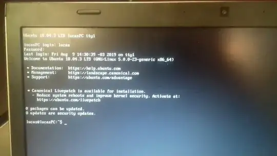

I can still log in with my user but now everything is like this:

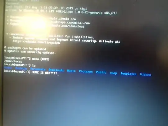

Since my $HOME folder is undamaged (everything I had there remained: see screenshot below) I want to copy it to a flash drive so I can install Ubuntu again without losing my personal files.
