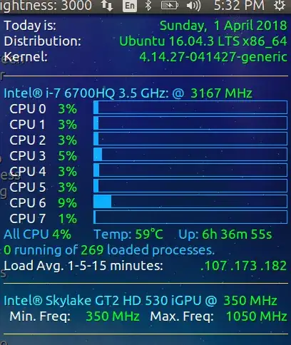

You will then notice CPU% utilization drop by about 5% but also notice speed will increase from about 1000 MHz to 3000 MHz and temperatures will spike by ~10 degree, depending on your processor:
I have noticed that even when set to powersave mode (as I always use) when Ubuntu first boots it runs in performance mode for 90 seconds before it eventually kicks into powersave mode.
None-the-less after manually setting the governor to performance mode using the appropriate command above. It has stayed in performance mode for 10 minutes now as confirmed by using the appropriate command above and doubly confirmed by conky display above.

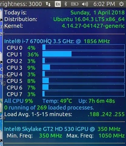

I left the governor set on performance for 30 minutes and it worked just fine. It might interest some readers what the conky display looks like when switching off of performance governor back to the default powersave governor:
CPU% utilization has spiked by 5%, but CPU frequency has dropped by 1500 MHz and temperature has decreased by about 10 degrees. Overall I think powersave mode is the best for most configurations.

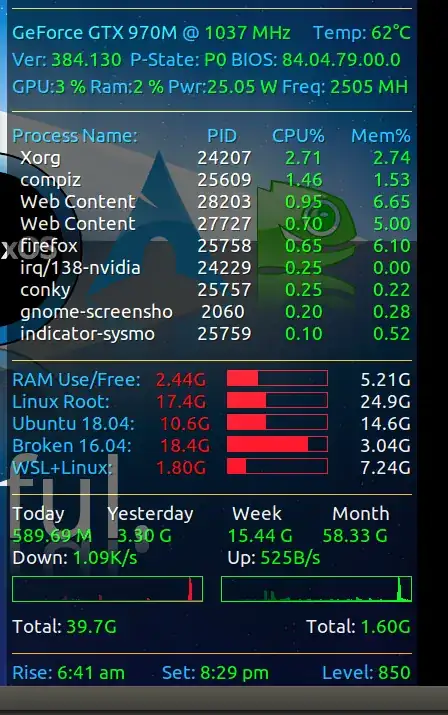

Bottom half of conky screenshot
Just noticed the conky images above are top half only. The bottom half is included below so the code makes more sense. Also note the Intel iGPU appeared before because prime-select intel was used. Here the nVidia GPU appears because prime-select nvidia was used:

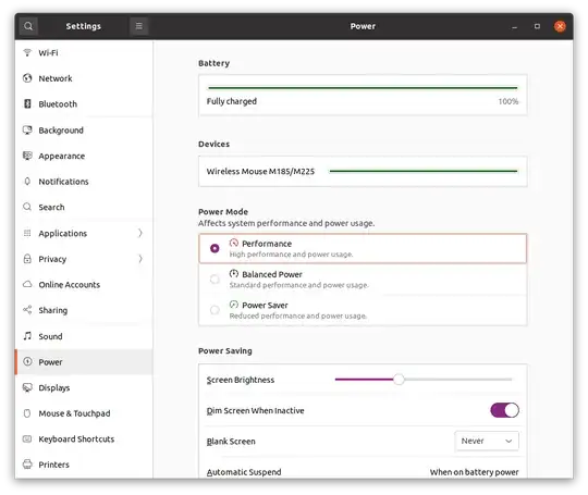

Settings > Power Mode
On Ubuntu 22.04 and 24.04's Settings under Power, I spotted a setting that might be of interest, you have the choices for "Power Mode":
  • Performance
  • Balanced Power
  • Power Saver
As of 24.04, there's also a shortcut for it on the top right hand corner thingy:
TODO how are those implemented more precisely? How does Ubuntu 22.04 handle power modes? appears to ask it. This option did not affect:
cat /sys/devices/system/cpu/cpu*/cpufreq/scaling_governor
which were still set to powersave.
Its source appears to be at: https://github.com/GNOME/gnome-control-center/blob/bb89fc1d0ef1d30ebc804c064f7813f76b473106/panels/power/cc-power-profile-row.c#L131 but from reading it quickly I just can't easily see what it does.
