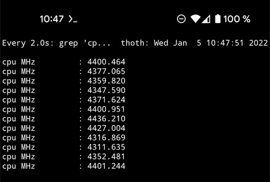

 watch "grep 'cpu MHz' /proc/cpuinfo"
While this is active, you can also spam the processor to see what maximum real-time speeds it can reach by openssl speed

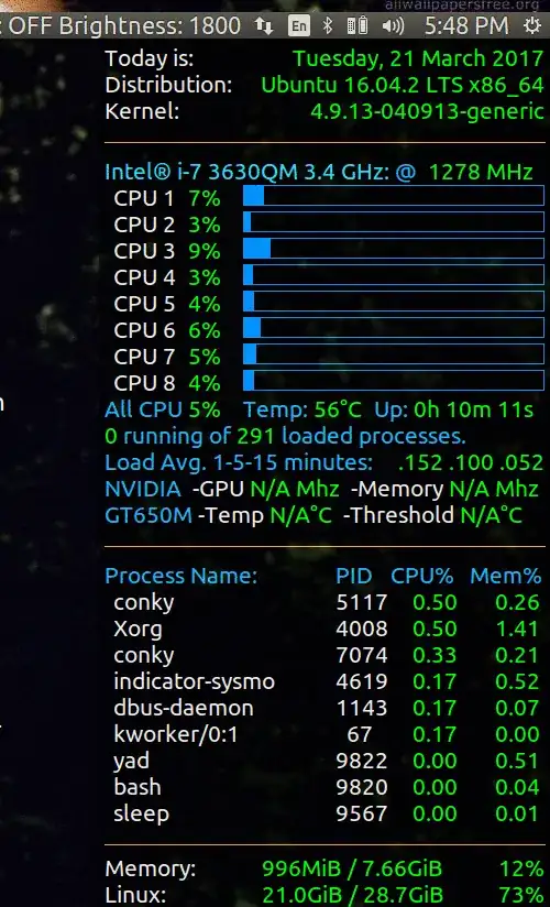

My favourite is to use Conky where you can paint your own picture:
This sits on the right of my built-in display all the time. The relevant code for the CPU section is:
${color2}${voffset 5}Intel® i-7 3630QM 3.4 GHz: ${color1}@  ${color green}${freq} MHz
${color}${goto 13}CPU 1 ${goto 81}${color green}${cpu cpu1}% ${goto 131}${color3}${cpubar cpu1 18}
${color}${goto 13}CPU 2 ${goto 81}${color green}${cpu cpu2}% ${goto 131}${color3}${cpubar cpu2 18}
${color}${goto 13}CPU 3 ${goto 81}${color green}${cpu cpu3}% ${goto 131}${color3}${cpubar cpu3 18}
${color}${goto 13}CPU 4 ${goto 81}${color green}${cpu cpu4}% ${goto 131}${color3}${cpubar cpu4 18}
${color}${goto 13}CPU 5 ${goto 81}${color green}${cpu cpu5}% ${goto 131}${color3}${cpubar cpu5 18}
${color}${goto 13}CPU 6 ${goto 81}${color green}${cpu cpu6}% ${goto 131}${color3}${cpubar cpu6 18}
${color}${goto 13}CPU 7 ${goto 81}${color green}${cpu cpu7}% ${goto 131}${color3}${cpubar cpu7 18}
${color}${goto 13}CPU 8 ${goto 81}${color green}${cpu cpu8}% ${goto 131}${color3}${cpubar cpu8 18}
${color1}All CPU ${color green}${cpu}% ${goto 131}${color1}Temp: ${color green}${hwmon 2 temp 1}°C ${goto 250}${color1}Up: ${color green}$uptime

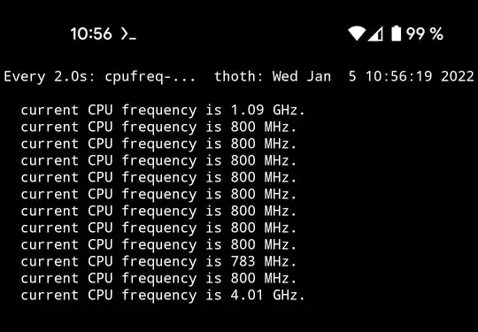

Please note that /proc/cpuinfo contains wrong values. Because of that I use this:
watch -n2 "cpufreq-info | grep 'current CPU'"
Result: enter image description here
And here the wrong result of /proc/cpuinfo: enter image description here
