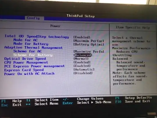

Here are the Power settings I had in my BIOS when I wrote this report:
BIOS power settings
I've since tried moving the Adaptive Thermal Management's Scheme for AC to be "Balanced" like it is for Battery, and tried moving the Intel SpeedStep setting for AC to be "Battery Optimized" like it is for Battery. I even disabled Wake-on-LAN, which had been set to "AC only". None of these eliminated the slowdown effect when plugging in AC power.
