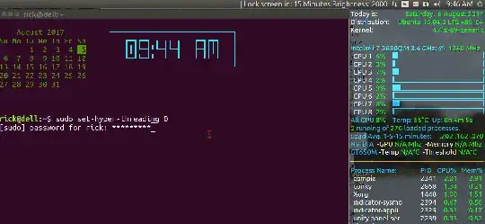

Display of CPUs when Hyper-Threading is turned off/on
Below you can see the CPU utilization when hyper-threading is turned off and a CPU stress test is performed. About 10 seconds later the same script is repeated with hyper threading turned on. Finally 10 seconds after that the script is run with hyper-threading turned off again:
Set Hyper Threading noht
The display is divided into two sections:
  • On the left half the terminal window invoking the script set-hyper-threading with the parameter 0 (off) and then 1 (on).
  • On the right half conky displays the CPU percentage utilization of CPUS 1 to 8.
First script run Hyper Threading off
The first time the script is run CPU Numbers 2, 4, 6 & 8 (according to Conky) are frozen at 3%, 2%, 2% and 2%. CPU Numbers 1, 3, 5 and 7 spike to 100% while stress test is run.
