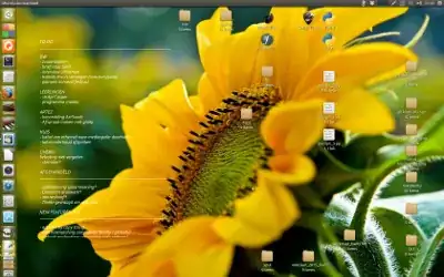

An example of a default resolution of 1680x1050:

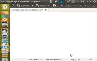

Running gedit, automatically changing to 640x480:

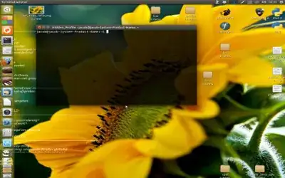

Running gnome-terminal, automatically changing to 1280x1024:
