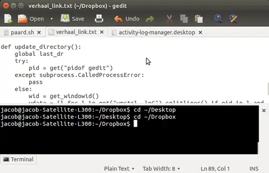

Automatically set the working directory to the currently front most file:
cd on tab switch

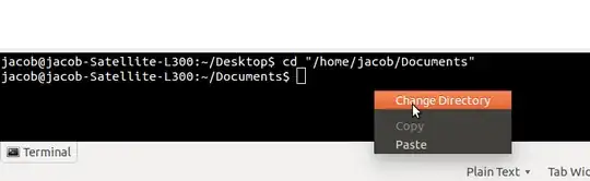

The built-in cd menu of the gedit terminal
An alternative, almost with the same comfort, could be the gedit terminal built in function. It only takes two mouse clicks (one right- one left):
  • Right-click with the mouse in the terminal window
  • Choose "Change Directory" and the terminal window will cd to the currently frontmost file's directory:
