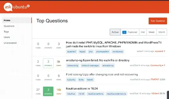

I tried to change the size of my fonts. Now the font is looking ugly. I can't change to previous form. See how ugly it is looking!
I am using KUBUNTU 18.10. What should I do?
