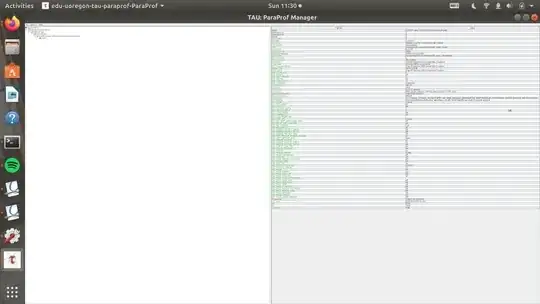

My laptop is hp spectre x360 13 and my OS is Ubuntu 18.04.4 LTS. I want to use a Java-based application called paraprof(here). Sorry, I don't use Java so I put part of its description below (don't know whether it helps):
ParaProf requires Oracle / Sun's Java 1.5 Runtime Environment for basic functionality.
Java JOGL (included) is required for 3d visualization and image export. Additionally,
OpenGL is required for 3d visualization.
The problem is when I launch it the font size is too small to read: paraprof
I think this is a scaling problem on high DPI display? The built-in display of my laptop is 3840 * 2160, and in setting - screen display section I set the Scale option as 300%.
I encounter a similar scaling problem before, the font size of spotify is also really small. I solved this one by adding alias spotify="/snap/bin/spotify --force-device-scale-factor=3.5" in my bashrc file. I wonder if there is similar solution to this one.
I see some people suggest to use -Dsun.java2d.uiScale=2.0 here, but I am not sure how to use this.
