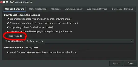

software-properties-gtk option "Source code"
I recommend this for the desktop:
then under the "Ubuntu Software" tab click "Source code":
This has added some deb-src lines under /etc/apt/sources.list, and now I can do sudo apt-get build-dep <package>.
