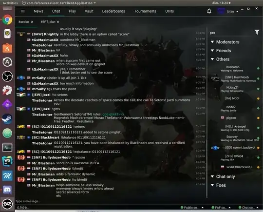

up and running thanks to @edwinksl 's "Python 3 with PyQt5" guide. marked him as solution. good job!

Since I asked a lot has happened. FAF now has more or less linux support. they even have a wiki to installing it (and per distro!) :
https://wiki.faforever.com/index.php?title=Setting_Up_FAF_Linux#Debian.2FUbuntu
it's not guaranteed to fit your needs, more can be found by digging in : http://forums.faforever.com/viewtopic.php?f=2&t=4507
right now the wiki isn't all that up to date.
for awhile I could get faf to run with native python, no virtualenv needed but QT's aver changing dependencies and package composition as well as the FAF usage of them has broken that again ... temporarily I hope !
rest assured I've got it running personally and I'm here to offer solace (try skipping steps 6 & 7 first they may be unneeded ):

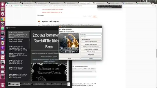

Note: the steps for Python 3 with PyQt5 are proven to work while the steps for Python 2 with PyQt4 and PySide are still experimental.
Python 3 with PyQt5 (proven to work)
It appears that the 474-feature-py3 branch of the FAForever/client GitHub repository uses Python 3 with PyQt5, which contains QtWebKit. Therefore, using this branch is the most straightforward solution. Note that PyQt5 (but not PyQt4) can in fact be installed with pip, so that makes things way more convenient.
Steps for Python 3 with PyQt5:
  1. cd into a directory of your choice, which will be ~/Desktop/temp for the purpose of writing this answer, git clone the FAForever/client GitHub repository and git checkout the 474-feature-py3 branch:
    mkdir ~/Desktop/temp
    cd ~/Desktop/temp
    git clone https://github.com/FAForever/client.git faf-client
    cd faf-client
    git checkout 474-feature-py3
  2. Create and activate a virtualenv for Python 3 (the default is Python 3.5 for Ubuntu 17.04) and force-upgrade pip just to make sure it is up-to-date:
    virtualenv venv -p python3  # replace python3 with python3.6 if you want to use Python 3.6 instead
    source venv/bin/activate
    pip install -U --force-reinstall pip
  3. Use pip to install PyQt5 and from requirements.txt:
    pip install PyQt5
    pip install -r requirements.txt
  4. Download the faf-uid binary into faf-client/lib and make it executable:
    wget https://github.com/FAForever/uid/releases/download/v4.0.4/faf-uid -O lib/faf-uid
    chmod +x lib/faf-uid
  5. Run python on src/__main__.py:
    python src/__main__.py
