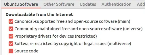

You need to be able to download source code from the Ubuntu repositories. The GUI way of doing this is:
  1. Press Super to start the Dash and search for "Software & Updates".
  2. Check the "Source code" box as shown below:
  3. Press "Close" and agree to reload sources.list.
