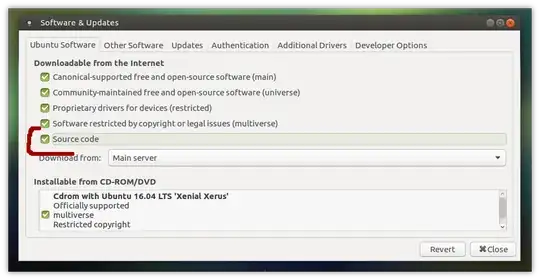

The easiest way to do this is to enable the "Source" repositories in the "Software sources" or "Software and updates" utility, which can be found in the dash, or under the "Tools" menu in the software center.
In the Software source utility, on the "Ubuntu software" tab, enable the "Sources" checkbox:
screenshot
This should be enough in order to allow you to get the source & compile. If it's not, enable the "source" repositories in the "Other software" tab too.
