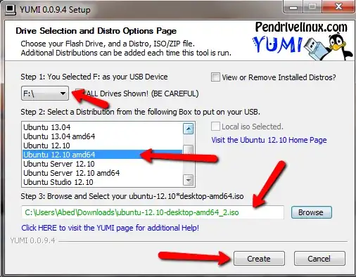

Creating a multiboot CD. you're limited to 1 ISO because of space, but you can create a multiboot USB, using Yumi. Once you choose the first ISO, and its created, it will prompt you if you want to add another ISO.
