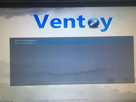

I have the Ventoy app running on my target machine and showing 22.04 and 23.04 in the menu, but when I select either of these, I next get a black screen with no progress. I'll recopy the ISOs on the USB, but its not working yet. I doubt both my ISOs are corrupt, so I suspect there is a problem with Ventoy.
screenshot
