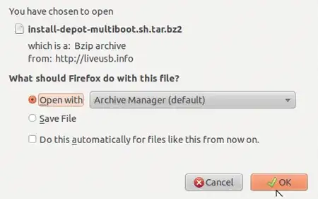

  1. Download and Open the Script with Ubuntu's Archive Manager
Open multiboot.sh with Download Manager

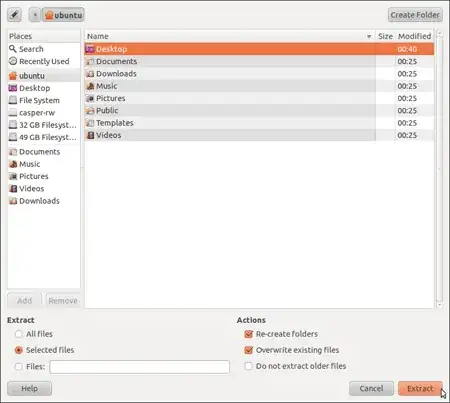

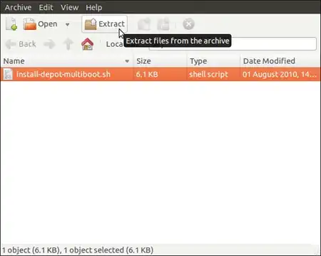

  1. Extract the install-depot-multiboot.sh Script to your Desktop
Extract MultiBoot
Extract to Desktop

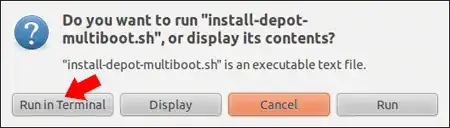

  1. Double Click install-depot-multiboot.sh from your desktop and select the option to "Run in Terminal"
Select to Run Script in Terminal
