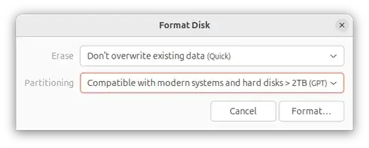

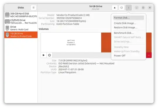

  1. Format the 16 GB USB drive by the disk utility to GUID Partition Table. Booting with this partition table and a bios-based device will be successful after installing the grub boot loader to the USB drive. I tested that by myself befor making this answer. enter image description here enter image description here
  2. Create two partitions. the first NTFS partition will include the grub boot files (after installing the grub boot loader on the disk), the grub.cfg file, the ntloader file, and the Windows installation files. The second one is to dd the Ubuntu ISO file on it.

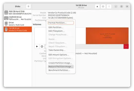

  3. Use the disk utility to write the Ubuntu ISO file on the second partition.

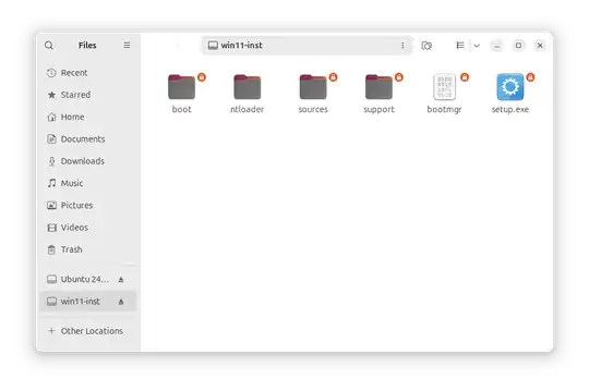

  1. Copy all files from the Windows ISO file to the first partition.
  2. Download the ntloader and extract the /ntloader directory from the compressed file to the first partition.
