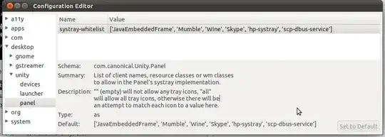

Firstly install dconf-tools from the software center ( or by clicking here) Then Press Alt+F2 and enter dconf-editor and run it.
dconf-editor alt-f2 dialog
Now navigate to Desktop -> Unity -> Panel.
configuration editor (dconf-editor) desktop.unity.panel
Now change the value of systray-whitelist to
"all"
Note that setting this to "all" will likely lead to other bugs, as the old notification area is unmaintained, instead consider adding applications you need individually instead of just enabling everything. You can reset it to the defaults by checking out this question:

Instead of changing it to 'all' I suggest adding the name of the desired application to the list. With this you avoid all kinds of problems with panel caused by the "all" value.
For example drweb indicator was missing, so I tried to add the command which executes dr web antivirus into the whitelist. The value was like ['JavaEmbeddedFrame', 'Wine', 'Update-notifier']. I changed it to ['JavaEmbeddedFrame', 'Wine', 'drweb-cc', 'Update-notifier'], then I logged out and logged in, and the indicator was on the panel.
The best way, and ubuntu version independent is to run dconf-editor, and find (ctrl+F) this string "systray-whitelist" (unless they change it...)
You can edit its value to simply ['all'], you can restore it by clicking "set to default" button also.
Or find out what icons you want to show, one by one and add them there.
