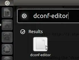

Try installing the dconf-tools from software center.
Press ALT + F2 to run a command and search for dconf-editor

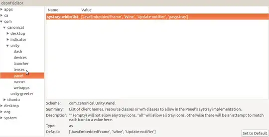

Highlight the whitelist entry as shown in the picture and click the Set To Default button.
Log-off and login for the change to take effect.

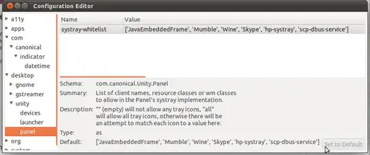

In 12.10 systray-whitelist seems to be in com.canonical.unity.panel, as shown below:
