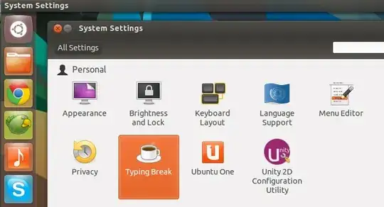

Find the applet in the Control-Center to launch:
image and source for the information
In a similar manner as for 11.10, workrave is available from the Precise Universe repository if you do not wish to use a PPA.
