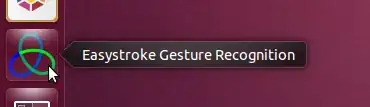

Open it from the Dash again
If you open Easystroke Gesture Recognition while it's already running, it will show the configuration window instead of starting a duplicate instance.
Unity Dash icon for Easystroke Gesture Recognition

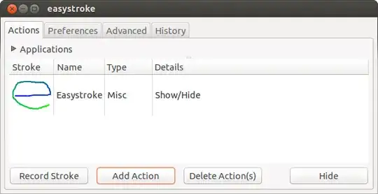

Define a gesture
Once you've gotten the configuration window open, you can create an action for easy access in the future. Set the type to Misc, and the details to Show/Hide.
Easystroke Gesture Recognition - Actions - Show/Hide Configuration
