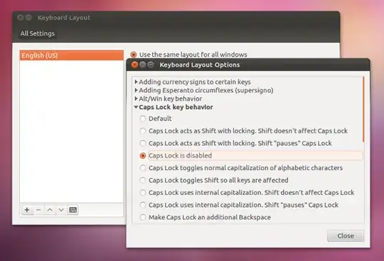

In Ubuntu 11.10 - 13.04
  1. Open the Keyboard Layout application and click the "Options" button.
  2. A list of rebinding options will apear. Select "Caps Lock key behavior".
  3. Select your preferred Caps Lock repurposing option.
Screenshot of available options

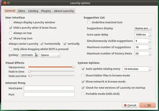

Edit:
I don't know why it seems inconvenient with another Keyboard keys.
But Launchy works fine with me after trying it with CTRL+Super+Space.
And you need to white-list launchy to the tray icons. See How do I access and enable more icons to be in the system tray?. Also you need to add it to the Start Up applications, as it won't work when it is not opened.
After all, As an alternative for Launcy, try Synapse for its best integration with gnome and unity.

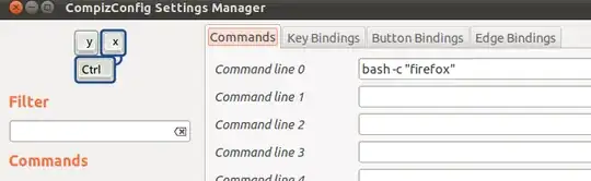

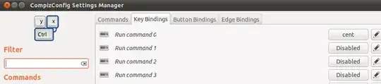

Configure Compiz
Start the CompizConfig Settings Manager
In the general section, ensure "Commands" is enabled and configure a command as shown:
N.B. enable the key binding and use "grab key combination" to recognise your "cent" key. You cannot get compiz to recognise the cap lock key itself unfortunately.
Obviously - change "firefox" for whatever command you use to start "launchy"
Now when you hit the Caps Lock key, compiz will recognise the mapped "cent" key and run the command - in this case firefox - in your case "launchy".
