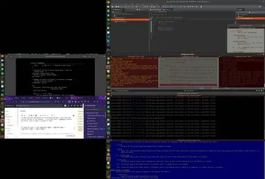

Since writing this answer, Ive started using Terminator, as it lets you open as many terminals as you need (within reason) and save all of their attributes. So If you want to maximize the terminal, then split it into 6 or 7 terminals, and finally change each to a seperate profile (each with it's own transparency, color, command on launch, etc.), you can save all of that to a single layout.
I believe it is just
sudo apt install terminator
To show you just how powerful this program can be, I will show the current content of my displays. I currently have 3 seperate displays. Currently, this is what is loaded to them:
To load all this, I type Ctrl + Alt + Super + s.
Normally, one of the hassles of rebooting, for me, is reconfiguring all the windows that I need. However, they usually need to be in one of 5(ish) layouts. So I just set them each up and to a keybinding with terminator. I still have to open anything else I need, but one of the presets usually gets me most of the way.
NOTE: the non-terminal apps do not normally start with a layout launch. You have to set them to a terminal's launch command. But with 6 separate terminals launching, that is 6 opportunities to run commands. To launch an outside app, you have to use the ; or && operator. The 'command' is actually anything you can fit on a line, but you have to launch a shell somewhere in there.
