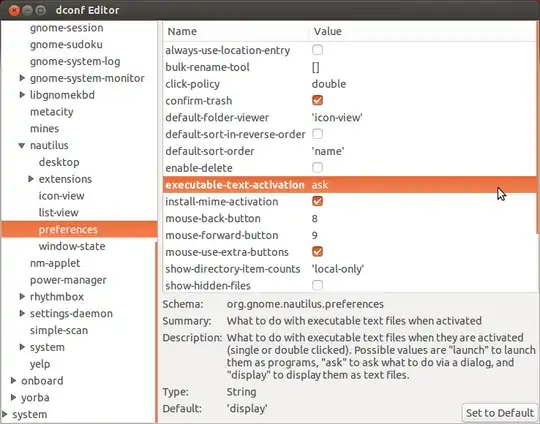

Follow these steps:
  • Install dconf-editor because it isn't installed by default.
  • Hit Alt+F2, type dconf-editor and hit Enter.
  • In dconfg-editor goto: orggnomenautiluspreferences
  • Click on executable-text-activation and from drop down menu select:
    launch: to launch scripts as programs.
    OR
    ask: to ask what to do via a dialog.
  • Close dconf-editor. That's it!

I think this is a nuisance caused by Gnome people who decided to change that default behavior we were accustomed to.
To fix it, you can;
  1. install (if you haven't already) and start dconf Editor,
  2. go to: org > gnome > nautilus > preferences, and
  3. change the value for executable-text-activation back to ask (or even launch, if you prefer).
If you want the same Nautilus behavior as Root as well you can repeat the steps above, starting dconf Editor this time as Root.

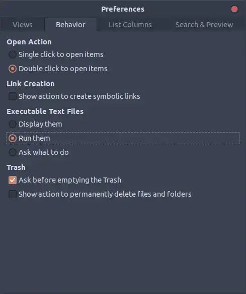

Using GUI
  1. Depending on which Ubuntu version you have,
    • 14.04 or 16.04
      In Nautilus, open this from the menu bar:
      Edit → Preferences
    • 18.04+
      Files → Preferences
  2. Then, in the 'Behavior' tab, select "Run them" (previously "Run executable text files with they are opened").
    Alternatively, select "Ask each time" instead if you would like a dialog (example) asking you whether to edit or execute the file.
    screenshot
Using Command line
If you prefer a command:
dconf write /org/gnome/nautilus/preferences/executable-text-activation "'launch'"
Note: Both GUI and command line methods work only for Nautilus (the default graphical file manager in Ubuntu).
