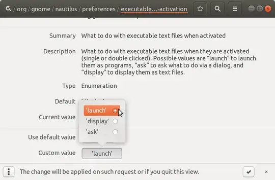

I tested this and it worked fine. Ensure your script begins with the correct shebang, e.g. #!/usr/bin/env bash .
Then follow these steps:
  • Hit Alt+F2 to run a command.
  • Type dconf-editor and hit Enter.
  • In dconfg-editor go to: org ➤ gnome ➤ nautilus ➤ preferences
  • Click on executable-text-activation and from drop down menu select:
    launch: to launch scripts as programs.
    OR
    ask: to ask what to do via a dialog.
    screenshot
  • Close dconf-editor. Thats it!
Alternative way, using terminal: Run:
gsettings set org.gnome.nautilus.preferences executable-text-activation 'launch'
Note: The file should be executable. You may also need to change permission of file. Right click and set "Allow executing file as program"
screenshot
Source.

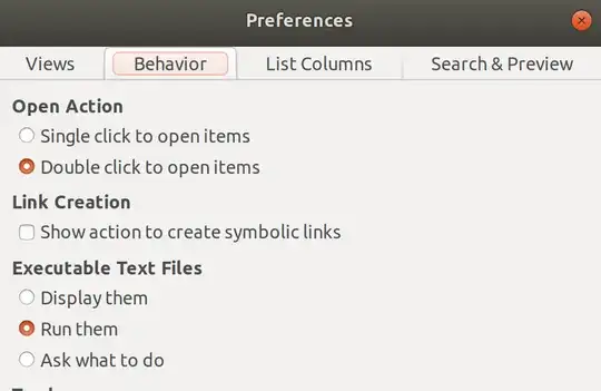

On Nautilus (AKA Files)
  1. Go to Files (Edit on Unity (17.04 or below)) > Preferences > Behavior tab
    screenshot
  2. Change the settings for executable text file.
    screenshot

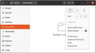

For Ubuntu 20.04:

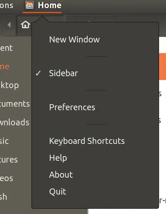

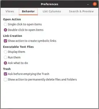

  1. Open Files (Nautilus is called Files now), click on the hamburger menu and select Preferences.
  1. Go to the Behaviour tab and select what's suitable from the Executable Text Files section

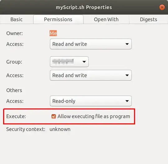

In Ubuntu and all Unix based OSes, afaik, nothing is set as executable by default. There are two ways of doing this.
  1. Right click on the script or file you want to execute. Go to Properties then to the Permissions Tab. Click the check box that says Execute.
  2. Open a Terminal cd into the directory where the file is found. Type chmod ugo+x filename. This will set the file to execute.
Now your users can double click to their hearts content.

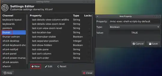

If you're using XFce then you can make script executed in Thunar by executing this command:
xfconf-query --channel thunar --property /misc-exec-shell-scripts-by-default \
             --create --type bool --set true
or by using gui xfce4-settings-editor and creating the same properties.
Run xfce4-settings-editor, then enter:
  • /misc-exec-shell-scripts-by-default
  • Boolean
  • TRUE
picture of xfce4-settings-editor

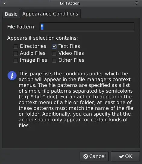

As a complement to the answer about Thunar: that answer would re-enable a previous feature of Thunar to execute scripts on double click. But that feature was considered a security risk.
To avoid that, maybe the most elegant solution is to get a pop-up window with a question like "What do you want to with that file: Run or edit?" (similar to what you have in other file managers like PCManFM and Nemo) when clicking that file - by using Zenity: here.

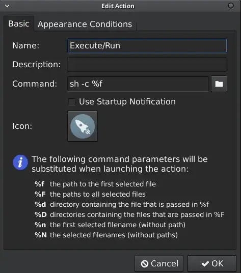

An alternative would be custom actions, perhaps the best feature Thunar has.
The command that I use for running an executable text file is sh -c %f, for a custom action called "Run/Execute script".
The appearance conditions are simply "text":
A similar command can be used for running in terminal a such script ("Run in terminal"), while keeping the Xfce4 terminal open:
xfce4-terminal -H -x %f

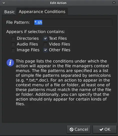

Optionally, and maybe preferably, in order to hide such options for all text files except the executable ones, a way is to restrict appearance use to .sh files (or .py files if the case, etc), under "Appearance conditions":
-- before renaming the executable files accordingly.

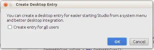

Specially for Android Studio You can follow my original answer here:
To Create Desktop Launcher:
  • Click on Create Desktop Entry.. from Tools menu.
  • It will be prompt for password, enter password of your current login.
  • Finally it will be display notification in Android Studio screen like:
  • You can see in Applications => Programming => Android Studio, and you may see on desktop also after restarting system.
Thank you. :)
