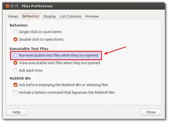

GUI
Depending on which Ubuntu version you have,
  • Before 13.04
    In Nautilus, go to this menu:
    Edit → Preferences
  • 13.04 and later
    Files → Preferences
Then,
in the 'Behaviour' tab, enable "Run executable text files with they are opened"
Command line
If you prefer a command:
dconf write /org/gnome/nautilus/preferences/executable-text-activation "'launch'"
Note: Both GUI and command line methods work only for Nautilus (the default graphical file manager in Ubuntu)
