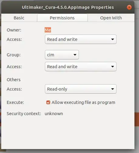

It seems like the file needs execution permissions.
This is what worked for me:
  • Right click on the file, click on Properties.
  • On the Permissions tab, make sure you have checked the 'Allow executing file as program'
  • Close it and go open the file. It now runs correctly.
screenshot
