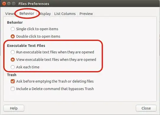

Help in Right-Click > Properties > Permissions explains this behavior:
If the file is a program, such as a script, you must select Allow executing file as program to run it. Even with this option selected, the file manager may still open the file in an application or ask you what to do. See Executable text files for more information.
The default action when double-clicking a script is to open it in the editor. To change this option:
  1. Click Files in the Launcher, select Edit > Preferences and then the Behavior tab:
  2. Select the default action when opening an executable text file:
    • Run executable text files when they are opened
    • View executable text files when they are opened
    • Ask each time
"Ask each time" is probably the right setting here, as you certainly don't want to accidentally execute a script when you just want to open a text file, especially since executable and non-executable text files share the same icon.

I suspect that you need to change the settings for the file manager so that it will either run the bash script directly, or ask you if you wish to run the script or display the code.
I don't know if the current version of Ubuntu's file manager works the same way, but a couple of years back, the fix was as follows:
"Open the Nautilus file manager and click on the gear wheel (Location Options) in the top-right corner of the window. Navigate to Preferences – File Preferences – Behaviour – Executable Text Files. A set of radio buttons allows the default option to be set. My preference is for “Ask each time”. Then, when I double click on a script file, I am given the option of either running the script or displaying (editing) its contents."
(See: https://linuxnorth.wordpress.com/2013/11/02/running-bash-scripts-in-ubuntu/)
